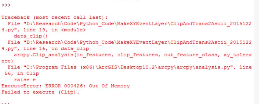

But I got the "out of memory" error.
If anyone knows how to solve this problem?

p = Pool(7)  this line confuses me then.  Perhaps the files are just too big then. ... and I did notice that you tried it in-memory

Have you thought about smoothing/generalizing your polygons, if that's an option for you? Reducing the vertices will result in a smaller file, but at the expense of losing some spatial resolution. What about splitting-up some of your features? Have you considered increasing your memory? How much do you have installed?

... and what if you take out the multiprocessing and the in_memory workspace. Does it work? If I run into memory problems it is often related to the in_memory workspace.

Before you run the Clip tool, run the Dice tool (Dicing Godzillas (features with too many vertices) | ArcGIS Blog) on the layer you are trying to clip. The Dice tool is specifically for the case when the input geometry is "too big to process" (one of the symptoms being the 'out of memory' error).

with the caveat that it requires an Advanced license Dice—Help | ArcGIS for Desktop
