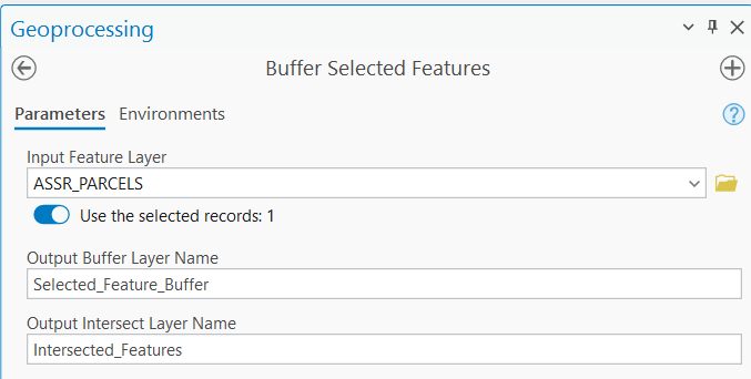

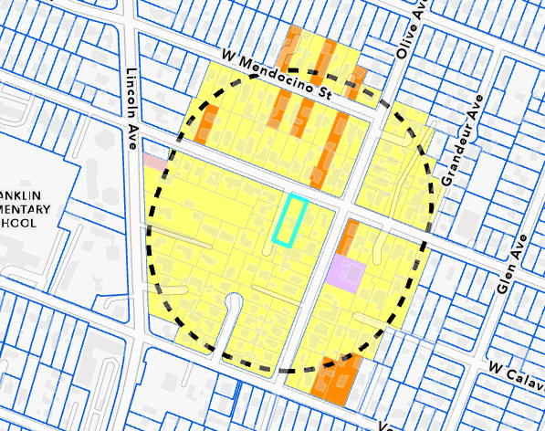

Hello,
I created a python toolbox with assistance from this community that now works in ArcGIS Pro. The tool creates a 500-foot in memory buffer layer around a selected parcel and then creates another memory layer of the parcels that intersect the buffer. The script applies layer files to the resulting layers for styling. At this point, I want it to publish it and have it work in an Experience Builder Analysis widget. The resulting memory layers will need to now be permanent layers though it seems (I read memory layers can only be created in ArcGIS Pro). As a result, I was just thinking of tweaking the toolbox somehow to use the ArcGIS API for Python to create and add the layers to the current web map. The layers created could be hosted on the same ArcGIS Server as the GP Service and the GP service could overwrite the layers in ArcGIS Server each time it's ran. Anyway, any input on how this code can be changed to accomplish this is greatly appreciated.

BrandonPrice1_0-1758676216828.pngBrandonPrice1_0-1758676216828.pngBrandonPrice1_1-1758676300741.pngBrandonPrice1_1-1758676300741.png
