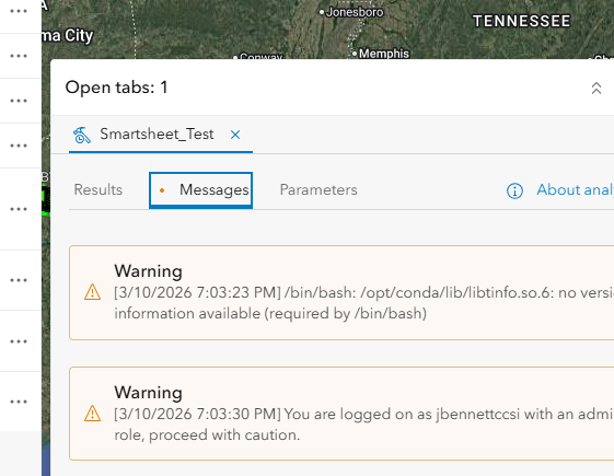

However, when running a Web Tool neither print() or AddMessage() appear on the messages tab in this output window:
It will display system warnings, but not my custom messages.

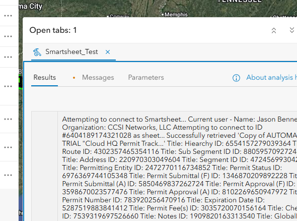

It produces this:
One long text string with no breaks. I've attempted to create breaks (you'll see the "\r\n" in my latest).
I'm calling output_messages in place of print() and it appends each message to the output file.

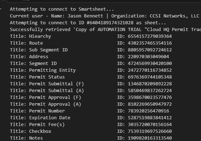

It needs to look like this:
Does anyone have any suggestions on how to do this?
