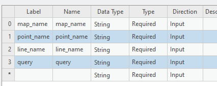

When you create the tool how are you defining the parameters? like below...
map_name = arcpy.GetParameterAsText(0)
point_name = arcpy.GetParameterAsText(1)
line_name = arcpy.GetParameterAsText(2)
query = arcpy.GetParameterAsText(3)
