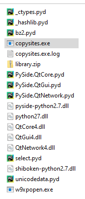

The folder that contains all the tool's files does not have a .py file.  It only  has lots of .pyd and .pyc and .dll files, plus an .exe which is the GUI.  I have no idea how the previous employee built it.  Those files are not human readable or editable.  Is there any way to edit any of it?

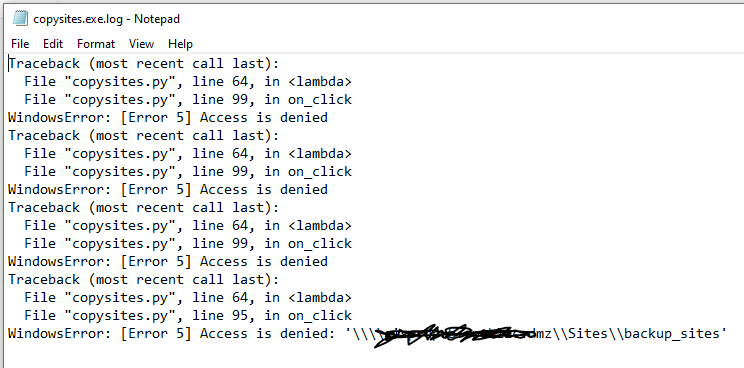

I noticed that the copysites.exe.log file contains text that refers to a file called copysites.py, but that does not exist in the folder or any of the subfolders.
