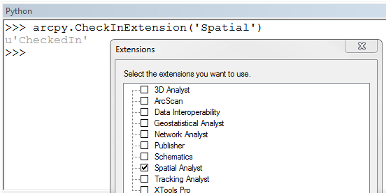

A further complication that will confuse the user is that when they open the  "Customize->Extensions" menu to check if the SA extension is checked out, the tick will still be in  the extensions check box as checking the extension in via code does not update the GUI. E.g see screenshot below
