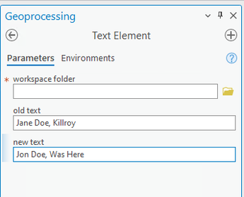

Is there an updated version of this for Pro? When I use the script with Pro-related updates there are no errors in the tool, but no changes are made. I'm currently debugging and the couple things I'm questioning whether they're actually doing their job are the counter and replace().

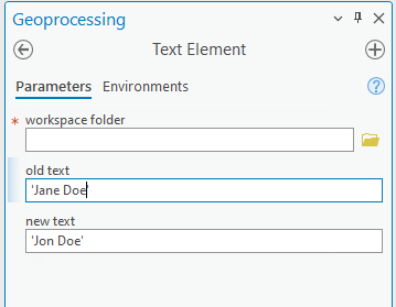

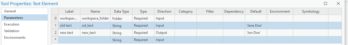

@TonyAlmeida After implementing your suggestion, I did some further debugging and found the problem. These two parameters require a space after the separator when imputing multiple values, and I wasn't doing that.
oldList = Old_Text.split(', ')
newList = New_Text.split(', ')
So, if you have a space in the split() function then you need to put it after the parameter value too. Also, make sure your old text matches your existing layout text element or else it won't be found.
