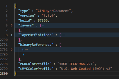

At the end of the day, almost everything in the mapping module is just editing the JSON definition of layers in an aprx or on a webservice. The CIM is just raw access to those definitions. aprx, mapx, and lyrx files can all be opened directly in a text editor and read as json data. The only have a small CIMLayerDocument wrapper around the CIM for the contained objects that tells Arc how to structure the contained layers:
