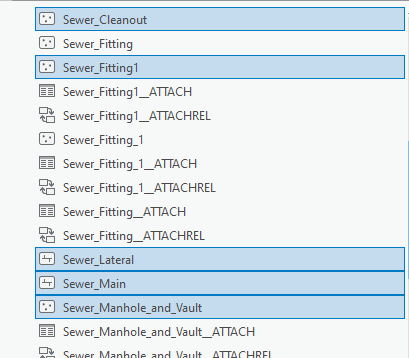

bcarpenter87
Hi Jeff. Thanks for looking at this for me. So I have all of the layers (not all of them will be affected of course, only the ones indicated in the txt) into my 'Experiment.gdb.
I ran the first part of the code you provided in PyCharm just to see what it did. And I think it did what it was supposed to? I've provided an image.
With things set in place, I just needed a few more dots connected for me. How do I run the first part of the your code with either of the second part of the code to get to where I want to be?
I see that the layers in the gdb have underscores in them. Will I need to change them as @BlakeTerhune suggested?  Do I perform all of this in the Python Window?
