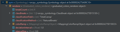

When I add the updateRenderer to 'GraduatedColorsRenderer' in code, it does not set the breakCount.  It remains 1 regardless of any number is set to using sym.renderer.breakCount = len(breaks) or sym.renderer.breakCount = 6
Manually changing the layer render to Graduated in Pro, it shows 5 classes (I updated the test shapefile to have more polygons that would be within the ranges for testing) in the UI:
But in code (debugger) it still defaults to 1 for breakCount and the classBreaks:
Maybe there is a way around this, but it seems like a bug to me.

I don't know how this escaped me, I think I was focused on something else at the time. I think the fault is in it wont let you create more breaks/counts than features. Stepping through the code it does not set the sym.renderer.breakCount to 6 for the CEA layer so when you iterate over its list of 1 item, i is 0 and it is setting the 0 value:
brk.upperBound = breaks[i]['upper']
brk.label = "<=" + str(breaks[i]['upper']) + "% Canopy cover"
brk.symbol.color = {'RGB': breaks[i]['color']}
strCur = f"Adding break at {breaks[i]['upper']} with colour {breaks[i]['color']}\n"
The loop then stops there and that is all it does. You can test this by doing i+1 and it will show the value for 1 in the toc.

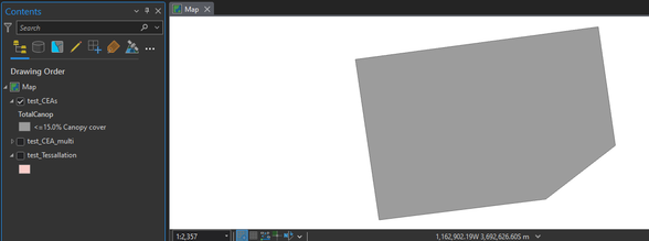

gives this, with <= 15.0% for the CEAs:
You can add conditionals for featureclasses that have any feature counts below the 6 in the breaks and go from there. Hope this helps-
