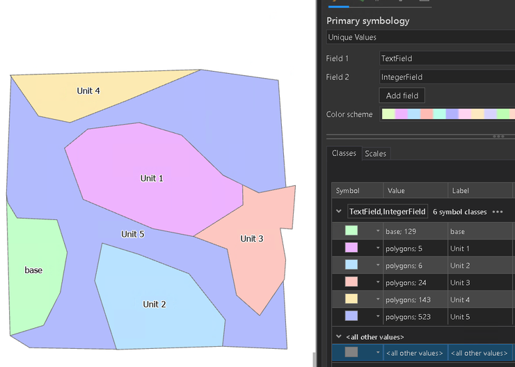

I'm working with a FGDB FC that has data, of sorts, stored in the symbology.
What I mean is: there is UNIT information in the symbology as labels, yet that UNIT information doesn't exist in a field in the attribute table of the FC anywhere.
Using ArcPy, is there a way to print a list of the layer’s symbology class values and symbol labels? I have 20+ layers, all with different symbology, so it would be ideal if I could do it programmatically.

You can get the symbology of a layer. Form there, you'll have to follow the rabbit hole to the single symbology items.
This script will loop through a list of layers in the active map, analyze their symbology and add a new field to each layer with the symbology's label value:
layer_names = ["TestPolygons"]
aprx = arcpy.mp.ArcGISProject("current")
for name in layer_names:
    # get the layer
    layer = aprx.activeMap.listLayers(name)[0]
    # get the symbology fields and items
    renderer = layer.symbology.renderer
    fields = renderer.fields
    items = renderer.groups[0].items
    # create a dict {values: label}
    item_dict = {tuple(i.values[0]): i.label for i in items}
    # add a new field
    arcpy.management.AddField(layer, "Unit", "TEXT")
    # insert the label values
    with arcpy.da.UpdateCursor(layer, ["Unit"] + fields) as cursor:
        for row in cursor:
            key = tuple([str(x) for x in row[1:]])  # item.values stores values as string
            try:
                row[0] = item_dict[key]
                cursor.updateRow(row)
            except KeyError:  # no symbology found
                pass

VincentLaunstorfer
Hi Johannes,
I found your python script really interesting as there is no easy solution to export symbology labels to table or field. However, I still get an error when trying to run your script.
I simply changed the first line in order to drag & drop layers from the current/active projects, using:
layer_names = sys.argv[1]
And I get the following error:
IndexError: list index out of range
It should be obvious to fix but I do not have much experience with the arcpy mp module and I am stuck.
Any help would be appreciated. Thanks
    # get the layer
    # add a new field
        for row in cursor:
            try:
                pass
JohannesLindner
MVP Alum
layer_names has to be a list (or other collection type).
My guess is that sys.argv[1] is a string, which the script iterates through, taking each letter as layer name. listLayers("a") returns an empty list, and then it correctly raises the IndexError when you try to access the first element of that empty list.
Have a great day!
Johannes
VincentLaunstorfer
You think setting up a dialog box properties for the Python script with a parameter (sys.arg[1]) defined as Layer multiple value, is read as a String? Should I read this parameter in a loop and assign the values to the List?
I though it may come from the script expecting a layer name only, and not the entire layer name with path... I will try to 'hard-code' the layer name making a list with a single entry...
JohannesLindner
MVP Alum
