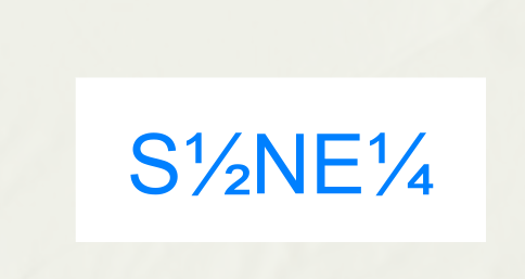

For context, this is what gdal is showing me for the strings
bytearray(b'S\xbdNE\xbc')
 I'm not sure how some things can read these correctly as fractions but not others?
