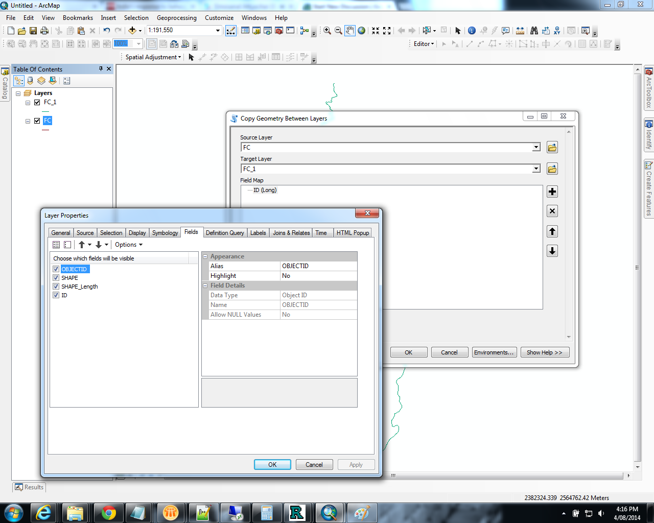

What i'm actually looking for is to establish join between two layers using more than one field. Users should be able to specify the field combinations.
HenryColomb
Hello Riyas
   Did you ever find a solution to this? I am able to populate the Field Map control in the validation script ok but when I try to access the shortcut menu there is no "Add input field" item like there is in the merge tool for example.
