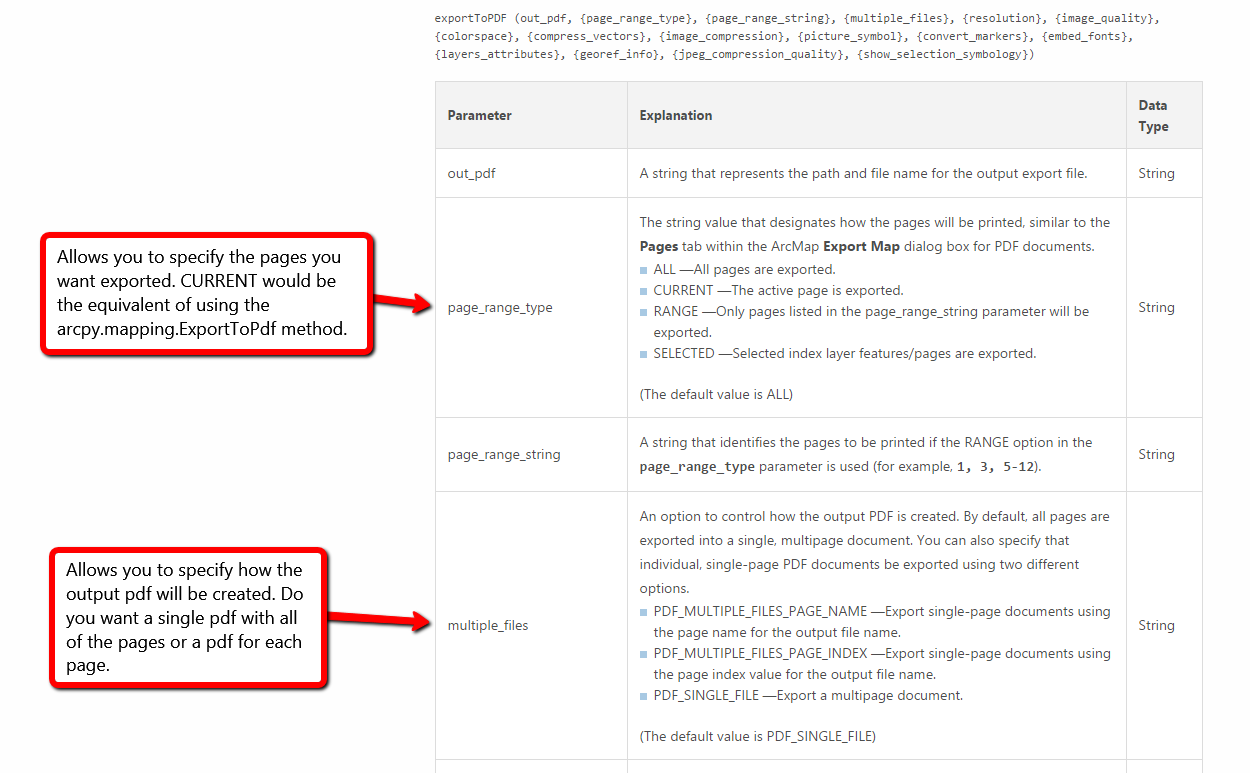

You'll want to take note that there are two options that allow you to export to pdf. The one suggested by David is the ExportToPdf method of the mapping class. If you decide to use this class then you also have to included logic to advance to each page within the map document. The method I suggested is the exportToPDF method of the dataDrivenPages class. This option would handle all of the iteration logic for you. This method would provide you with parameters to allow you to both specify the pages to print or how many pdfs to create.
Instead of iterating through each page, your logic could be as simple as follows (Note: I wrote this without verifying if it works😞

anayoung
Hi Freddie,
I apologize for the delay in response. I haven't had an opportunity to play with the code you posted for me yet. However, I want to thank you for walking me through it. As mentioned, I am new to scripting so I am not very good at picking out lines of code for use. Your code looks to be flexible and workable though. I will check out its functionality this week and post my findings. Thank you very much for your assistance - this novice appreciates the help. Until next time, Ana
