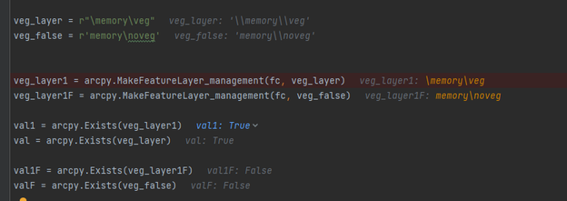

memory workspace and arcpy.Exists... Two of life's greatest mysteries.
If you take it out of your conditional, you will probably see it equate to False when checking if the dataset exists in memory- which is causing the 'exists' error message because its not getting deleted.
If you add a \ to the start of the variable memory\veg_lyr, you will see it equate to True, and execute the deletion.
veg_layer = r"\memory\veg"
fc = r'c:\ArcGIS\Local.gdb\address'
veg_layer1 = arcpy.MakeFeatureLayer_management(fc, r"\memory\veg")
val = arcpy.Exists(veg_layer)
val1 = arcpy.Exists(veg_layer1)
DavidAnderson_1701
Thanks.  I just tested this out.  Works fine.  I could tell the path was the problem.  Tried the \\ and / solutions.  Did not think of a preceding path separator,  I'll note that none of the ESRI documentation I could find about the memory or in_memory data space use the leading \ in the path names.
