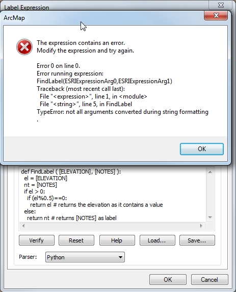

Error:
I can remove the line 'if (el%0.5)==0:' and it works fine (just a bit messy). So i know this line contains the problem.

Cast your elevation value to a float and it should work:
def FindLabel ( [ELEVATION] , [NOTES] ):
  el = [ELEVATION]
  nt = [NOTES]
  if el > 0:
    if (float(el)%0.5)==0:
      return el
  else:
    return nt

yes this float() fixed the error. Combining your suggestion with an else: statement it now runs flawlessly...
def FindLabel ( [ELEVATION], [NOTES] ):
  el = [ELEVATION]
  nt = [NOTES]
  div = 1
  if float(el) > 0:
    if (float(el)%div)==0.0:
      return el # returns the elevation as it contains a value
    else:pass
  else:
    return [NOTES] # returns [NOTES] as label
