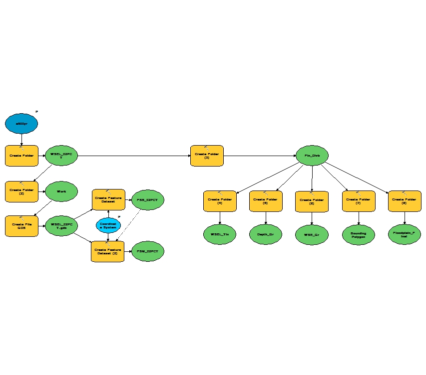

I exported a script listed from a model (both listed below) and keep getting the two errors Error 000837 and Error 000732 right around the Create Feature Dataset.  The script is also not creating folders within folders like it shows in the model.  The script obviously needs to be tweaked but I'm am a novice with Python and have no idea what exactly is causing all the issues in python.  Is anyone willing to point me in the right direction for fixing these error?  Any help would be greatly appreciated.
MeredithGreen
Update:  Figured it out.
a500yr = arcpy.GetParameterAsText(0)
Coordinate_System = arcpy.GetParameterAsText(1)
Needs to match the order of Parameters in the Script Properties in the toolbox.  (i.e. a500yr needs to be listed first and Coordinate_System needs to be listed second in the parameters.)
