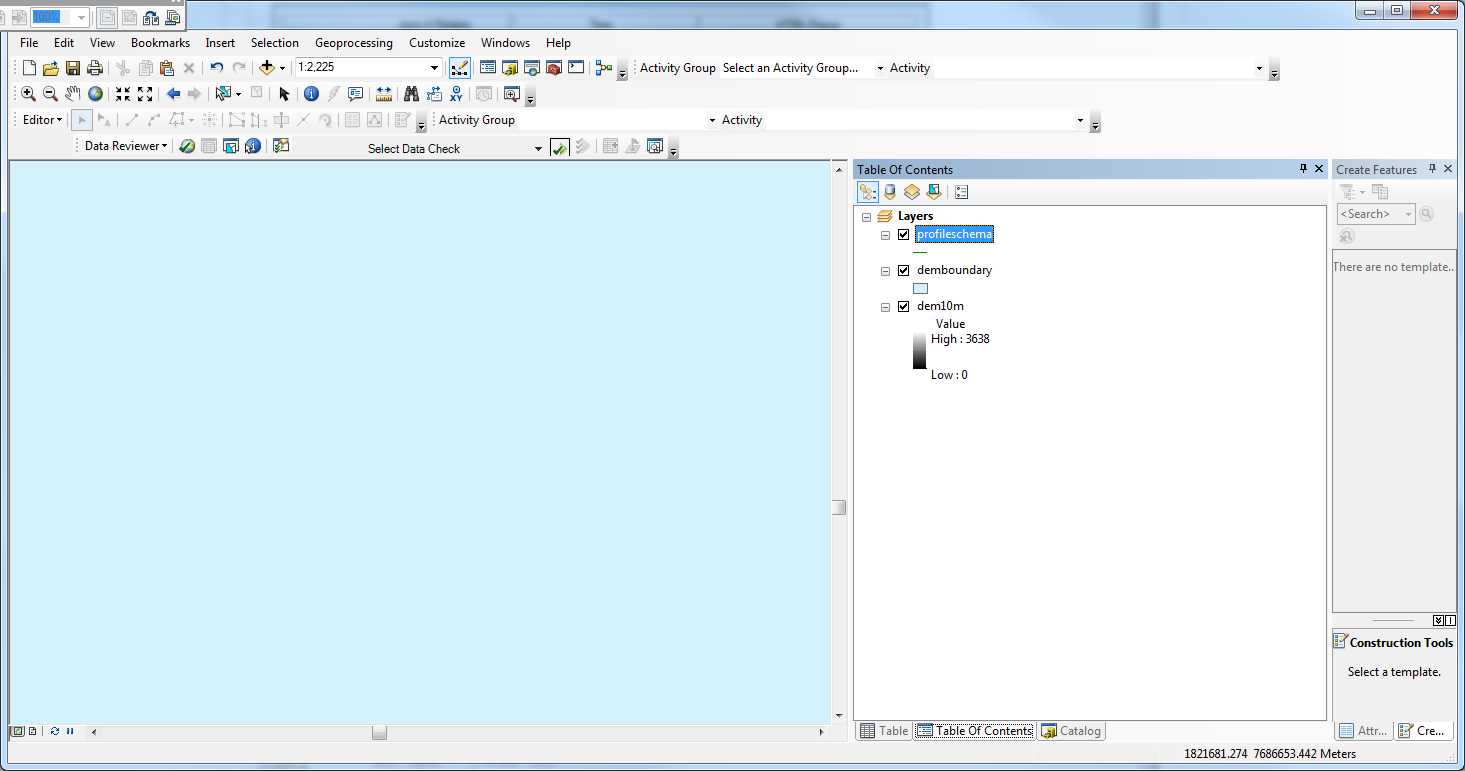

ionarawilson
I am not sure what we did to fix it .  I think  because we only needed to work with 10 meters, we did not need the other DEMs so we changed from
  1. demLayer1 = "dem90m"
  2.         demLayer2 = "dem30m"
  3.         demLayer3 = "dem10m"
to
demLayer1 = "dem10m"
        demLayer2 = "dem10m"
Your last error seems to indicate you are selecting an area outside the area that ESRI created the DEM for. You need to test in the same area of the extent of the DEM ESRI made available.

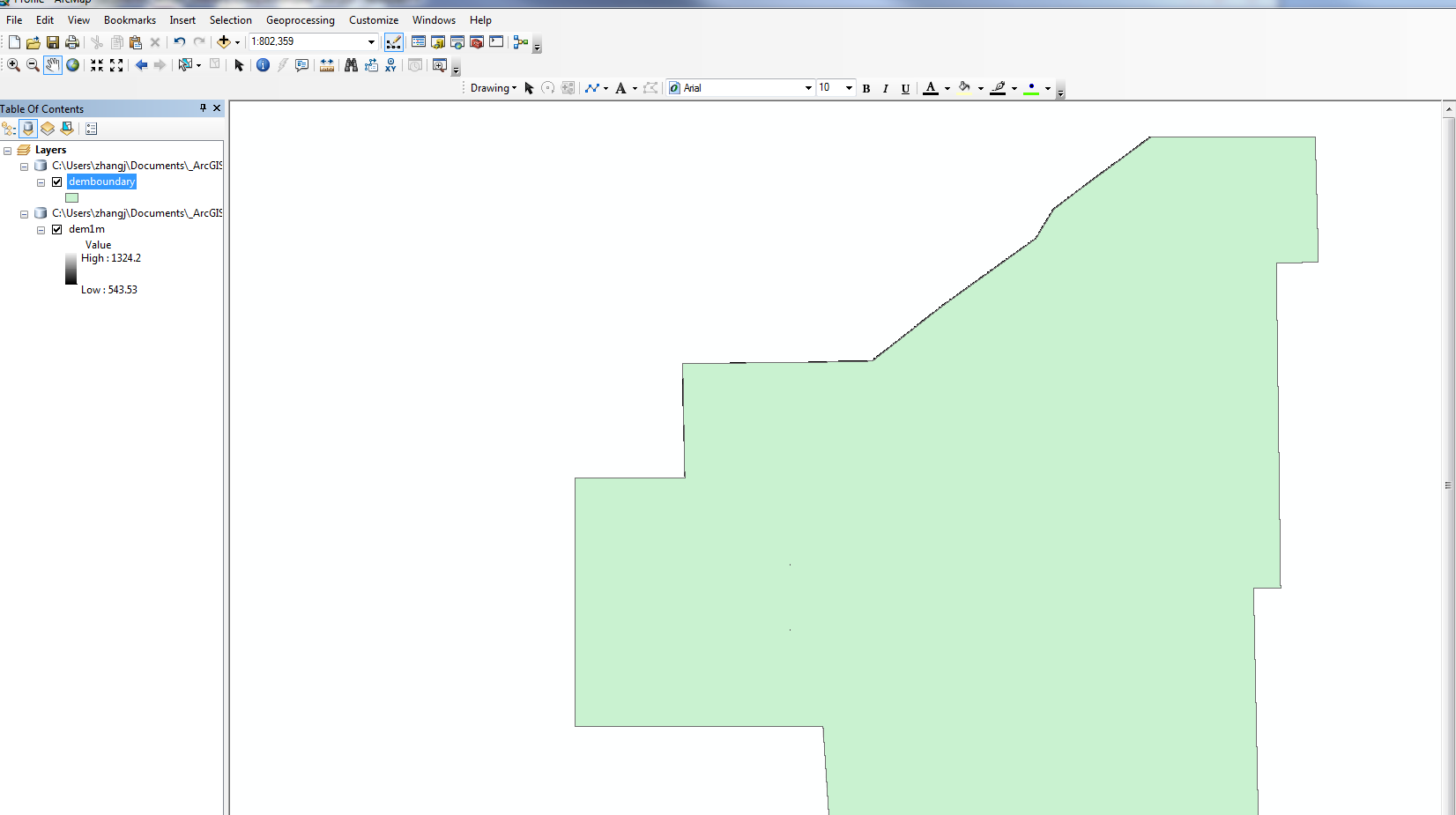

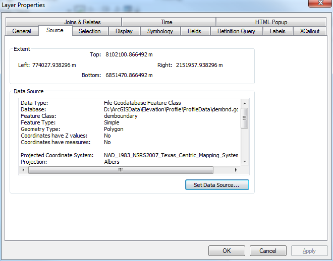

Thank you ionara, we want to work with 1 meter and I did change
to
demLayer1 = "dem1m"
But still get the "The input profile line you requested falls outside of the data currently available in this service." I am wondering if 1 meter is not supported? I also noticed that our
While comparing our dem1m raster data to ESRI’s sample dem data, I noticed the attribute of the image under DEM data all have 0 as their Low value, however ours is  543.53. I am wondering if we have to update our dem raster data to change the low value to 0? Here is what our profile.mxd looks like:
Regards,
Jin
ionarawilson
When do you get this error? After running the gp in a web service or during service publishing or when you run the gp in ArcMap? It is still complaining about the input not being in the same extent. I think the line file that you use to digitize might not be in the same projection. Make sure the spatial references are all the same. I dont think it has to do with low or high values. Notice on  my images, that all 3 files, the profileschema, the demboundary and the dem are in the same coordinate systems.
Here is the code that works for us. It is difficult for me to help since I cant see your code or the environment in your machine but I believe it is still a problem with the coordinate system. Good luck
Screenshot 2014-10-21 09.00.13.pngScreenshot 2014-10-21 08.51.48.pngScreenshot 2014-10-21 08.55.17.png
