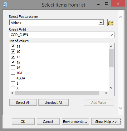

If you want to have the values in the dialog of the tool then this needs to be scripted in the tool validation. For example if you have a tool like this:
and the result is to print a where clause of the values like this:
... the code in the script would be:

In the validation, when the selected field is changed and has a value, the fc name and the fld name are read and used for the search cursor to create the list of unique values. This list is assigned to the filter.list of the 3rd parameter.

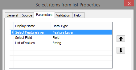

The parameters are defined as follows:

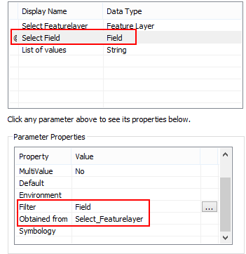

For the field you can filter the type of fields (optionally), but you will have to define "Obtained from" and select the feature layer.
The list of values is a Multivalue (Yes) and the filter is an empty value list.

Also the only way I can get a field list to appear in the UI is to use a feature class data type (feature layer = nothing). I would like to use feature layer so only layers in the data frame can be used.
  • In the parameter definition of the tool you have to define that the field is obtained from the featurelayer:
  • A feature layer type still let's you browse for a featureclass that is not in your TOC, so this is a possible source for errors
