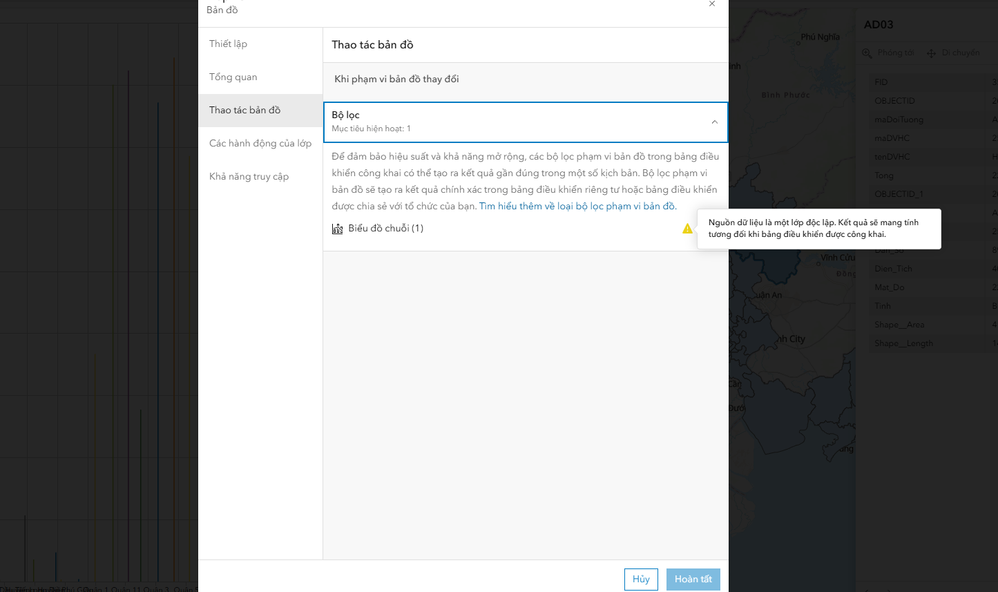

YNguyenNhu
Hello,
I want to manipulate the map on Dashboard, I have the attribute in the data layer. But the map does not display when I manipulate.
The error is: "the data source is an independent layer".
Please help.
Thank you!
