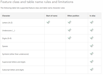

pyfans
Yes, after try again, I find it works when there are no any non-english (or say non-ascii?) character in gdb, but if there are Chinese character in gdb or featuredataset or featureclass's name, it just can't get featureclasses in featuredataset.
I tried 10.8.2 and 10.4.1.
Luke_Pinner
MVP Regular Contributor
I think feature class names need to use ascii characters only. From the help:
