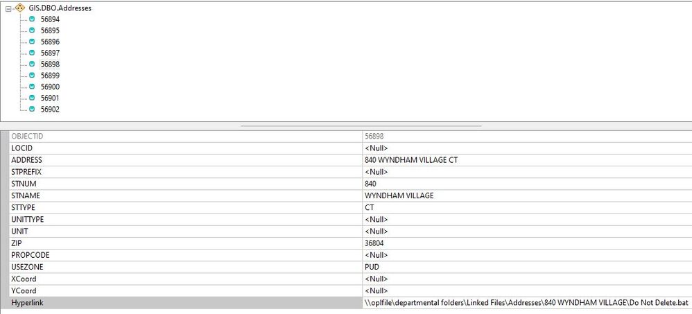

I want to develop a similar process, I am a bit green with python. I am just looking for a more efficient solution to add multiple address points. For instance, when a new subdivision comes along I receive the addressing and need to create a point with attributes. For a single street, the only fields that change are the house number and a hyperlink. The x,y changes as well but I can recalculate them when the points are placed. I just want a way to create multiple points at once in arcmap, If I have to move them manually once created that is fine. Any idea on a script or tool to do this. attached is an example of my attributes. Thanks!AddressSample.JPGAddressSample.JPG
