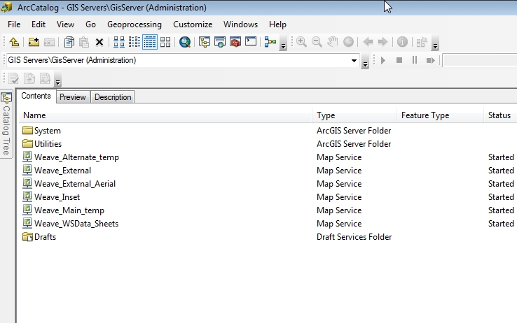

Hi,
I am wondering if anyone knows of a piece of python code that will return a list of all Map Service Connections???
I have several connections, I would like the script to find the connection name, and then use this info to perform further tasks.
Anyone done this?
Cheers
