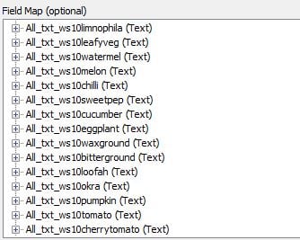

I have an attribute table with many fields where I have to change the field name. Most of the field names start with All_txt_ .
As I found out in the Data Management Forum, there is no way to automatically change all these field names in ArcGIS with a tool. Can someone tell me on how to do so with python? (I am not familiar with Python)

You can use the alter field tool either in a loop using a python dictionary or more simply create a bunch of one liners using something like excel to save typing:
e.g.
arcpy.AlterField_management(r'C:\Data\f.gdb\foodlyr', 'All_txt_ws10melon', 'ws10melon'),
arcpy.AlterField_management(r'C:\Data\f.gdb\foodlyr', 'All_txt_ws10tomato', 'wstomato'),
and then run that by pasting it into your python command line
now, if you really have a lot, a python script with a loop id the better way to go.

I think that the "AlterField_management" example provided by Sephe Fox is probably the best way to go. For older versions of ArcGIS you could go with the Add Field, Calculate Field and Delete Field, but if you have access to the Alter Field tool, you can better use that one.
The code provided by Sephe looks OK to me, but could be written a little shorter, assuming that they are all text fields and the "ws10" can also be omitted:
import arcpy
fc = r'path to your feature class'
flds = arcpy.ListFields(fc, field_type="String")
for fld in flds:
    if fld.name.startswith("All_txt_ws10"):
        arcpy.AlterField_management(fc, fld.name, fld.name.replace("All_txt_ws10",""), fld.name.replace("All_txt_ws10",""))
Note: although the help states that the input field should be of type field, it actually only works if you provide the input field name.
