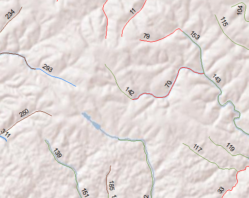

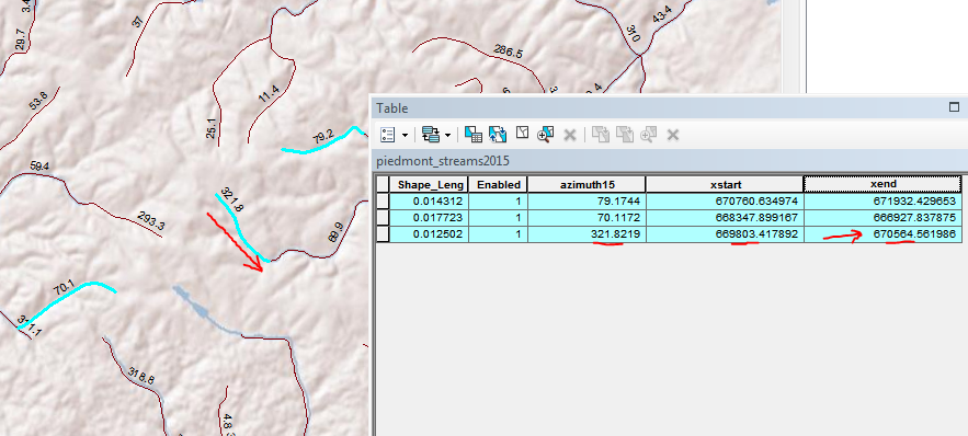

Thanks for the postings, but I just tried this on an NHD dataset looking at the azimuths of stream polylines.  It doesn't return the correct azimuth  The azimuth -90 to 90 works, but between 90 and 270 degrees are incorrect. The streams flow direction is reversed.  I am going to look at the math, and will post if I see an improved answer.

Here is some code that works for me, where the "answer" does not as shown in previous post.
def CalculaAzimuth(linea):
    if (hasattr(linea,'type') and linea.type == 'polyline'):
        xf = linea.firstPoint.X
        yf = linea.firstPoint.Y
        xl = linea.lastPoint.X
        yl = linea.lastPoint.Y
        dX = xl - xf
        dY = yl - yf
        PI = math.pi
        Azimuth = 0 #Default case, dX = 0 and dY >= 0
        if dX > 0:
            Azimuth = 90 - math.atan( dY / dX ) * 180 / PI
        elif dX < 0:
            Azimuth = 270 - math.atan( dY / dX )* 180 / PI
        elif dY < 0:
            Azimuth = 180
        return Azimuth
    else:
        return False
which comes from here
Syntax Errors when Calculating Azimuth with Python in Arcgis 10 - Stack Overflow
Wish I could make use of "atan2(y,x)" but I couldn't get it to return 0-360 correctly in all quadrants.
