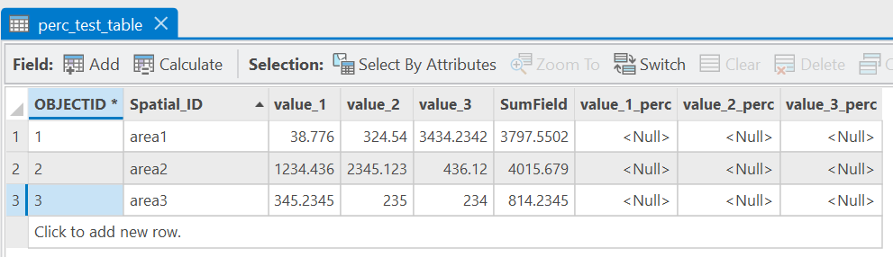

Hi all, I've been trying to automate the calculation of some land cover percentages per area, but I'm not a programmer so I'm not sure how to fix where I've gotten stuck. So far, I have been able to create and calculate a field with the sum of all of the area values, and new fields for the percentage calculations to be in.
I've tried a few things to calculate these new fields, including using CalculateField() in the place of AddField(), but I wasn't able to get the expression to work because referencing a variable which is a field name breaks it and makes it think they're both strings instead of using the values within the fields.

You can use an f-string to dynamically insert the field name into the calculate field expression.
fields = arcpy.ListFields("perc_test_table")
for field in fields:
    if field.name not in ['OBJECTID', 'Shape_Length', 'Shape_Area', 'SumField', 'Spatial_ID']:
        arcpy.management.CalculateField(table, f"{field.name}_perc", f"!{field.name}!/!SumField!", "PYTHON3", field_type="DOUBLE")
