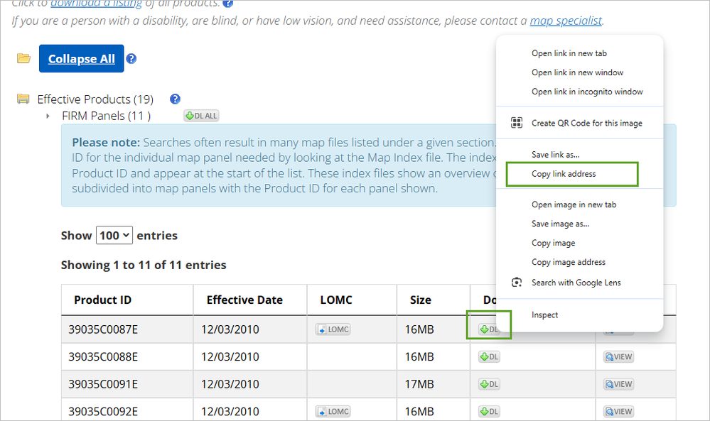

If you have people manually downloading you could have them copy the link (right-click, copy link address) on the download links and record the links.
It looks as though the download links are of the form:
https://msc.fema.gov/portal/downloadProduct?productTypeID=FINAL_PRODUCT&productSubTypeID=FIRM_PANEL&...
Seems like you could copy the Product IDs from the table.
If you know all the ProductIDs that you want, you can use Python to iterate over that list and concatenate each Product ID onto the base string for the download URL, e.g.
