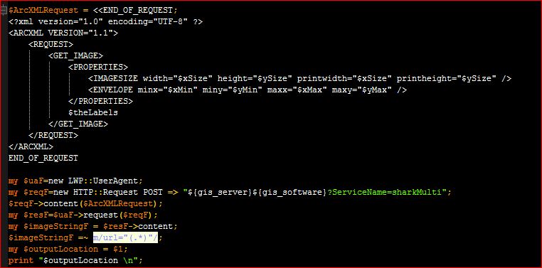

In perl, I create the xml I want, then send it to the server pretty easily as seen below:

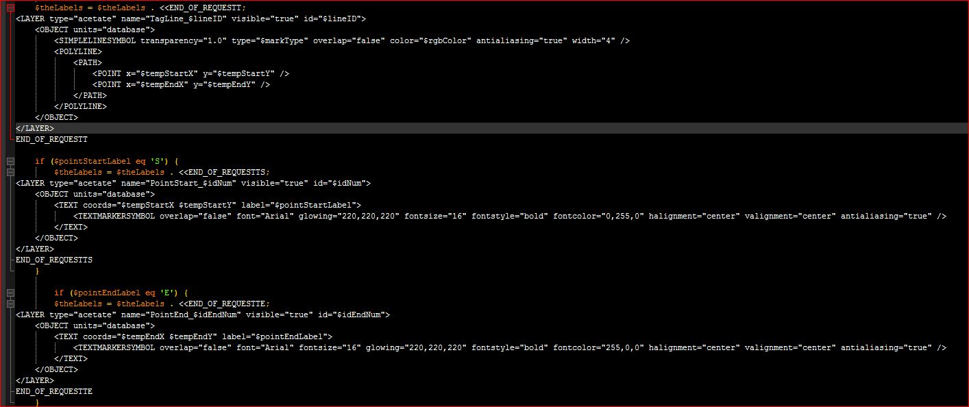

In this code I create the points and lines based on an array of lat/longs
Then I send the request to the arcims server which is hosting a basemap that these are drawn on and export a jpeg:
This seems much harder than it should be in python.  The script I've come up with so far is below.  It creates a points layer and adds it to an existing map (which works fine), but I cant change the symbols.  Basically I just want to use a text letter for each point.  The other tricky part will be creating the lines from it.  I will use the script and tool in arctoolbox, but this is really a ton more work and I still don't know how to change the symbols.  The only idea I came up with is to add a dummy layer that is symbolized how I want but turned off, then apply that symbology to the newly created letters.  But that won't give me the dynamic creation I need.  (These scripts do a bunch more, I just tried to simplify it here.)  At the end it exports a jpeg of the map.
