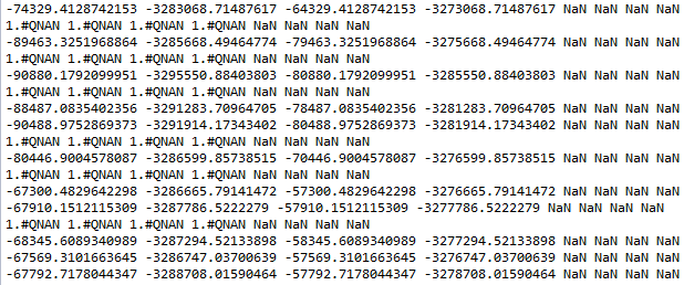

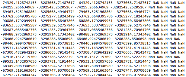

I need some assistance to figure out if the following is a bug, if so what work around can I use. I've written a Python Script I need to change the Processing Extent for each feature layer being processed. I obtain the extent for each feature layer using the following Python code:
process_extent = arcpy.Describe(site_buffer).extent
If I print process_extent , the results are what I would expect:
I then try to set the Processing Extent using the process_extent as input based on the following code:
arcpy.env.extent = process_extent
if I print arcpy.env.extent, the results are not what I would expect:

with arcpy.da.SearchCursor(sites_buffer, ["OBJECTID", "NAME", "SHAPE@"]) as scur1: #@UndefinedVariable
    for row1 in scur1:
        with arcpy.da.SearchCursor(sites, ["OBJECTID", "NAME", "SHAPE@"]) as scur2: #@UndefinedVariable
            count = 0
            for row2 in scur2:
                count += 1
                if row1[1] == row2[1]:
                    # processing start time
                    start_time = time.time()
                    process_extent = row1[2].extent
