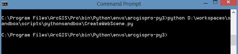

When running a CreateSceneLayerPackage as a standalone script, ArcGIS Pro crashes.
When running the same script in ArcGIS Pro python console, it works fine.

I do not get any error message. A Try: Except: does not catch anything. I directly have the ArcGIS Pro crash report window.
The exact same script works in ArcGIS Pro Python console and crashes when run from Windows cmd or Jupyter Notebook.
