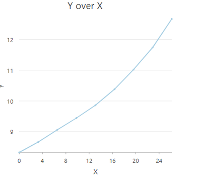

The code you posted should work without explicitly setting an `aggregation` in the constructor (this should just draw an unaggregated line chart), but it looks like you also tried setting `aggregation='min'` and that was also not drawing the chart how you expected. I tried with the following code:
c = arcpy.charts.Line(x='X', y='Y', aggregation='min', dataSource=r'c:\temp\test.csv')
c.exportToSVG(r'c:\temp\test.svg')
And it looks like the chart rendered as expected:
But if you are seeing the chart draw incorrectly when setting `aggregation='min'`, could you please post a screenshot if possible?

FredSpataro
@ChristopherAllen Thanks for the verification.  The 'aggregation=min' chart looks good when I use the full data.  Looks like I was tinkering and had converted the values to integers to see if 'doubles' were the cause...this produced non-unique values and then the aggregation kicked in and made the chart a bit off.
