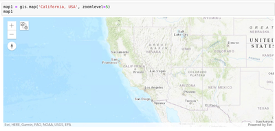

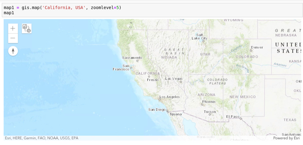

Creating a map in Jupyter notebook allows me to display a map, but when I use the export_to_html() or embed() methods, the map is blank.
#gis defined above using api key
map1 = gis.map('California, USA', zoomlevel=5)
map1
 This code produces this:

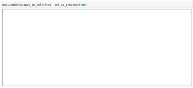

Using export_to_html(), the file is blank when opened in Firefox. When using embed, this is the result:

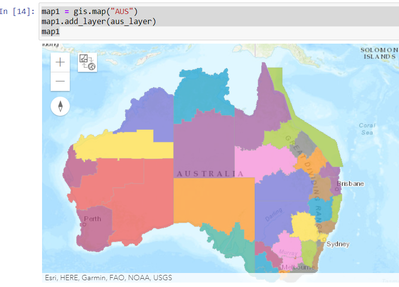

Same for me. Saves, but looks blank. I have tried screenshot and that was fine but is not what i want (I am using AGOL notebooks). Adapted from here: https://developers.arcgis.com/python/guide/part5-saving-updating-and-embedding-map-widget/
from arcgis.gis import GIS
gis = GIS("home")
aus_item = gis.content.get('b6e35d7687844967b8afe559275b7105') #this isnt public
aus_layer = aus_item.layers[0]
aus_layer
map1 = gis.map("AUS")
map1.add_layer(aus_layer)
map1
import os
file_dir = os.path.join(os.getcwd(), 'home')
if not os.path.isdir(file_dir):
os.mkdir(file_dir)
file_path = os.path.join(file_dir, 'Mapr.html')
map1.export_to_html(file_path)
TRUE
html saved as /arcgis/home/Mapr.html".... open that from files tab in Notebooks... opens blank. Cant seem to download. Help!
