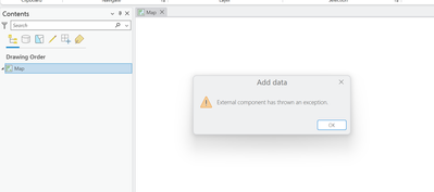

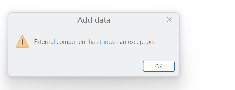

Hi All,

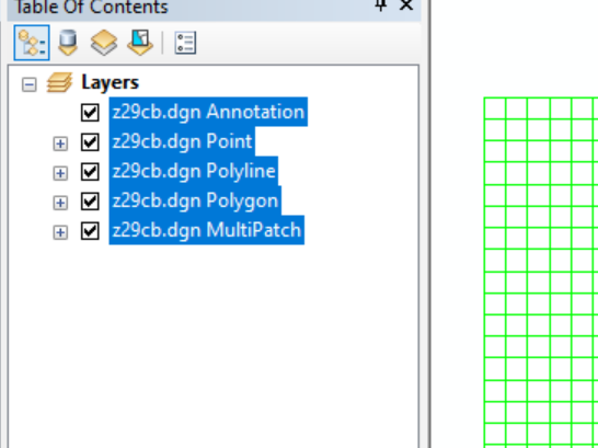

I am working with ArcGIS Pro 3.4 and attempting to add a DGN file to my active map . The same DGN file loads successfully in ArcMap 10.8.1 without issues. However, when I try to add it in ArcGIS Pro, the application crashes immediately
I tried arcpy script to add but still it is crashing ArcGIS pro 3.4

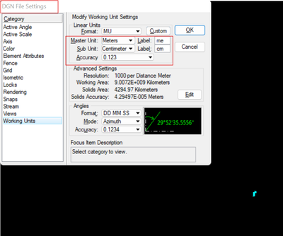

Using CAD to Geodatabase caused ArcGIS Pro to crash.
I discovered the issue was due to the units in the DGN file not being set to meters.
Changing the units to meters resolved the problem for me.
Here is the script for Microstation V8 in case someone else encounters this issue.
Public Sub changeunit()
Dim fol As Folder
Dim fil As File
Dim fso As New FileSystemObject
Set fol = fso.GetFolder("folder-path-to-DGN")
For Each fil In fol.Files
Set dsg = Application.OpenDesignFile(fil.Path)
    CadInputQueue.SendCommand "set units meters"
CadInputQueue.SendCommand "FILEDESIGN"
End Sub
But still ArcMap automatically assigning the units and ArcGIS pro does not.

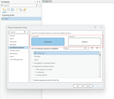

Why is the DGN file not opening in ArcGIS Pro 3.4 when I attempt to add it to my active map, while the same DGN file loads successfully in ArcMap 10.8.1 without any issues?
DanPatterson
MVP Esteemed Contributor
If it doesn't open in a blank map with no basemap or coordinate system set, then you should report it to Tech Support.  If it does open in an empty map, then preconditions needed to show it aren't met in Pro.
Remember, ArcGIS Pro is completely different piece of software and that is why they have the cad to geodatabase tool,
... sort of retired...
SumitMishra_016
Thanks @DanPatterson for replying!
I attempted to open the file in a blank map without a basemap or coordinate system, but the same error occurred.
I reported the issue to ESRI Tech Support, and they informed me that the data is corrupt. However, I want to understand why the DGN file opens successfully in ArcMap 10.8.1 but not in ArcGIS Pro 3.4?
Is there a way to identify what is missing in the DGN file for it to work in ArcGIS Pro?
