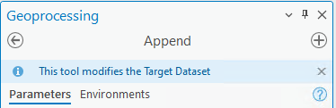

Is it possible to add notes at the top of custom tools, either with Python or the Toolbox GUI, similar to what I see here for the Append tool where it says "This tool modifies the Target Dataset"
I want to add a customised note of my own at the top of a custom tool.

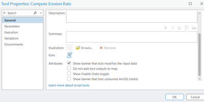

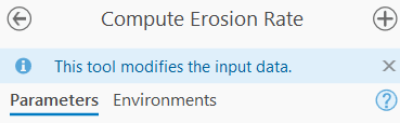

BenWoodward
I am not sure when this feature is added, but now, under the "General" tool properties, there is a checkbox that allows you to show a message like this at the top of the tool.
