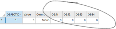

It is a bit complicated to explain what I am trying to do. I basically am running a calculation for each of these fields:
And the calculations are then put into a dictionary:
{'OBS1': 18, 'OBS2': 18, 'OBS3': 17, 'OBS4': 16}
And I then need to put each value in another field "Field 1" in another table. So 18 needs to go in row 1, 18 needs to go in row 2, 17 needs to go in row 3, and 16 needs to go in row 4 if that makes sense.
