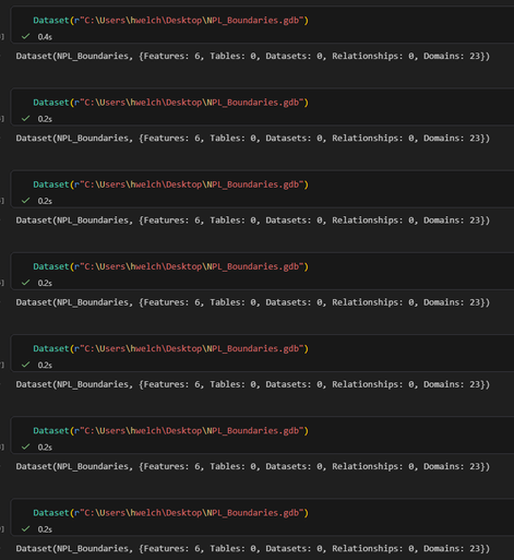

EDIT: Heres a screenshot of a Jupyter session where I used the concurrent walks to construct a Dataset object:
You can see that the first call is a bit slower than the subsequent calls, but it finds the same data every time. Anything that uses these objects knows what to expect, so if something is missing it'll throw an error telling me.

I will have to check out the library on GH.  I don't fully understand what the screenshot is showing?  Are you just running the same code block in a loop using the same data set(s) and arguments?  If so, the file system caching done at the OS level and the caching happening in ArcGIS code is likely influencing the results.  For code like this, the cold call performance is what is important, right?  What types of latency are you dealing with to your network file shares?  I know your screenshot is for a test database or example database, but are these times slow enough to warrant the time to optimize an approach in the first place?

When testing on our fileserver, this same database initialization went from 30s to 15s (we have thousands of file databases with ~100 feature classes and ~50 tables each). There is filesystem caching, but the actual Walk call itself is slow, and since I have to call it multiple times to get all the features initialized into the proper types, I had to pay that cost sequentially, now those 4 walks (FeatureClass, Table, Relationships, FeatureDatasets) are run concurrently.
I'm only using walk instead of the List* functions because Walk doesn't rely on the global arcpy.env state which can be finicky when you start changing workspaces rapidly.
The code I shared above has been implemented in the initializer of that Dataset object, so the sequential runs are just showing that it's not having issues missing things or losing data. The cold start is expected of course.

empty0.27s0.54s0.09s
tiny0.58s1.01s0.27s
flat_small1.53s1.76s1.13s
flat_medium6.09s6.79s5.22s
nested_medium4.84s5.60s3.57s
wide_datasets28.42s11.34s8.03s
deep_only2.84s1.88s1.01s
rc_heavy2.72s2.40s1.72s
xl39.19s30.27s24.11s
populated_production13.36s9.62s8.12s
JoshuaBixby
MVP Esteemed Contributor
I have used some of the publicly available reverse-engineered FGDB specifications to do this exact same kind of thing.  I even created a locking mechanism that emulates what some SDK calls do to ensure I am playing nice within the FGDB when reading it files, but that is a different discussion thread.
Looking at your network dataset times, I suspect 2/3 to 3/4 would actually benefit from multi-processing instead of multi-threading.  The bottleneck with Walk isn't the FGDB API but something in either Walk itself or internal code that Walk depends upon.  It is perfectly fine to have multiple, even many, processes reading the same FGDB at the same time without issue.  Even though initializing an arcpy license does take a few seconds, if enumerating a data type in an network share FGDB takes tens of seconds, that 3-second hit from initializing a library isn't that big.
