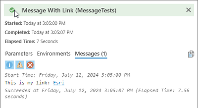

Hi @DuncanHornby,
There is an existing pathway for this that you might be interested in.
Internally, we do have some additional message features that were created for a subset of Pro teams that develop geoprocessing tools. Supporting links was part of that. It's organized as a json type of structure (like below) that you can use with the arcpy message functions.
Currently, it's not officially supported, and there is potential for this to change in the future.
msg = """json:
    [{"element": "content",
      "data": ["This is my link: ",
               {"element": "hyperlink",
                "data": "Esri",
                "link": "https://www.esri.com/"}]}]"""
arcpy.AddMessage(msg)
Hope this helps,
-Dave

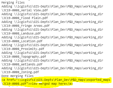

Bud
From @PeterKonrad in arcpy geoprocessing details clickable hyperlink:
[I want to] add a clickable hyperlink to the details of a custom python geoprocessing tool in ArcGIS Pro…I would like the end user to have the option to open the output pdf file from the results window.
