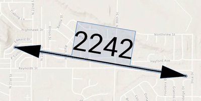

The same problem exists for Dimensions.
I'm finding that you can get them if you filter to Polygons, but again, you have to run a describe or ListFields() to figure out if they're actually what you're looking for.

Well, technically annotations are actually polygons in file geodatabases. You can copy the SHAPE field into a polygon feature class to get its footprint, although that changes with its symbology. Not sure how it is for dimensions but it's probably the same.
Funnily enough, they used to be lines in coverages, but that was most likely because the symbology and size of them was determined in the map instead of at the database level.
Edit: actually yeah dimensions function the same
