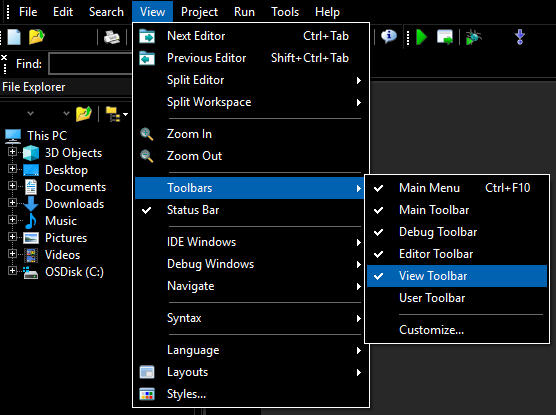

On the server where ArcGIS Pro is installed, follow the below steps to utilize it with PyScripter:
1.  Download and install the 64-bit version of PyScripter
2.  Open PyScripter and click View > Toolbars > View Toolbar:
3.  On the View Toolbar, click the Python Versions tool (first icon):
