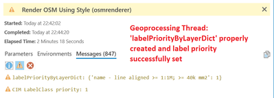

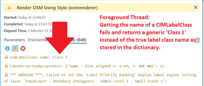

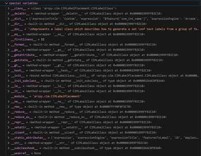

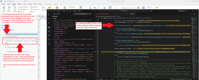

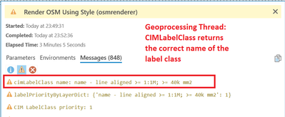

MarcoBoeringa
MVP Alum
@HannesZiegler

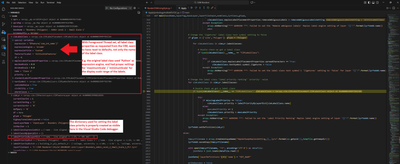

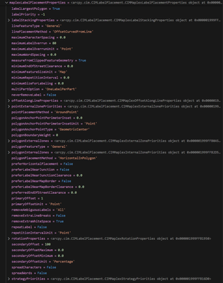

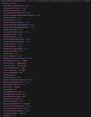

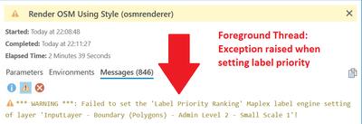

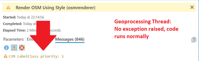

I ran into a highly confusing issue with one of my main custom build Python scripts after the ArcGIS Pro 3.6 / Python 3.13 upgrade.
When I attempted to run the script, which runs perfectly fine in Pro 3.5 / Python 3.11, the script immediately errored out with an "indentation error". However, there are none. Visual Studio Code, and PyScripter show the code as fine with their internal syntax checks.
One thing I finally noticed, was that the error seemed related to a commented out code section:
        for renderRule in renderRulesInit:
            renderRules.append(renderRule.split('|')[0].rstrip(' '))
##        for layeredRenderRule in layeredRenderRulesInit:
##            layeredRenderRules.append(layeredRenderRule.split('|')[0].rstrip(' '))
This code section lived directly under an:
if __name__ == '__main__':
    styleFolder = arcpy.GetParameterAsText(0)
    styleName = arcpy.GetParameterAsText(1)

I have been digging a bit deeper:
The example code I showed you regaring the CIM issue was a slightly modifed version of the original. The original is below:
# Change the label class "label priority ranking" 'priority' value
for cimLabelClass in cimLyr.labelClasses:
    # Double check we got a label class
    if type(cimLabelClass).__name__ == "CIMLabelClass":
        try:
            if missingLabelPriority == False:
                arcpy.AddWarning("labelPriorityByLayerDict: {}".format(labelPriorityByLayerDict))
                cimLabelClass.priority = labelPriorityByLayerDict[cimLabelClass.name]
                arcpy.AddWarning("CIM LabelClass priority: {}".format(cimLabelClass.priority))
            else:
                maxLabelPriority += 1
                cimLabelClass.priority = maxLabelPriority
        except:
            arcpy.AddWarning("*** WARNING ***: Failed to set the 'Label Priority Ranking' Maplex label engine setting of layer '{}'!".format(lyrToAdd.name))
            pass
Now, obviously, I am getting an exception on the Foreground Thread. But besides the CIM edit, there is also a dictionary lookup going on ('labelPriorityByLayerDict'). Now technically and programatically, that dictionary is guaranteed to contain the key being requested, so shouldn't error out, as it is in fact based on reading the exact same set of layer files being modified here.
However, to get further insight, I first re-tested my previous observations, confirming what I saw before:
This again shows the Foreground Thread throwing an exception during the CIM edit, but not the Geoprocessing Thread.
I then decided to also test the contents of the dictionary:
As you can see from the last two images, the dictionary is SUCCESSFULLY created in BOTH cases and contains the value 1 to set as label priority. This now unequivocally tells me the issue is with the actual CIM edit. I see no other way based on these results:

@JeffBarrette ,
I now ran the workflow with ArcGIS Pro attached to the Visual Studio Code debugger using the ESRI debugger extension. I don't think it turns up much new information, but as you can see, it is not just the label class name that got reset to 'Class 1', but all label class properties seem to have been reset to defaults in the CIM object.
MarcoBoeringa
MVP Alum
Part of the CIM layer object properties:

@JeffBarrette and @HannesZiegler ,
More important observations, see screenshots including debugger:
MarcoBoeringa
MVP Alum
@JeffBarrette
This is the full code of the 'updateSymbology' function. Note that I call it with 'aprxMap=None', see in the debugger.
Also note that in the particular example shown in the screenshots above, the 'len(inputSymbologyFields)=0' because it is a single symbol legend type.
Lastly, note that it is actually a string file path to the layer file stored on disk that is input to the actual call to the "Apply Symbology From Layer" tool, NOT the 'symbologyLayer' (which is however based on it, and was added to the TOC for technical reasons), which is in this function just used to check for symbology fields.
def updateSymbology(featureLayer,symbologyLayer,symbologyLayerFile,aprxMap):
    try:
        inputSymbologyFields = []
            symb = symbologyLayer.symbology
            if hasattr(symb, 'renderer'):
                for fieldNamePrefix in ['osm_','tgc_']:
                    if symb.renderer.type in ['UniqueValueRenderer']:
                        # Loop through all value fields, there can be multiple in case of a unique value renderer
                        for valF in symb.renderer.fields:
                            if valF is not None and valF.find(fieldNamePrefix) != -1:
                                inputSymbologyFields.append(['VALUE_FIELD',valF,valF])
                    elif symb.renderer.type in ['GraduatedColorsRenderer','GraduatedSymbolsRenderer']:
                        valF = symb.renderer.classificationField
                        for symF in [valF]:
                            if symF is not None and symF.find(fieldNamePrefix) != -1:
                                inputSymbologyFields.append(['VALUE_FIELD',symF,symF])
                        norF = symb.renderer.normalizationField
                        for symF in [norF]:
                                inputSymbologyFields.append(['NORMALIZATION_FIELD',symF,symF])
        if len(inputSymbologyFields) > 0:
            symbolizedLayer = arcpy.ApplySymbologyFromLayer_management(featureLayer,symbologyLayerFile,inputSymbologyFields,update_symbology="MAINTAIN")[0]
        else:
            symbolizedLayer = arcpy.ApplySymbologyFromLayer_management(featureLayer,symbologyLayerFile,update_symbology="MAINTAIN")[0]
        if StyleSupportingFunctions.getCanSetLayerVisibility(symbolizedLayer) == True:
            try:
                symbolizedLayer.visible = False
            except:
                pass
        if aprxMap is not None:
            aprxMap.addLayer(symbolizedLayer, "AUTO_ARRANGE")
            symbolizedLayer = aprxMap.listLayers(symbolizedLayer.name)[0]
        return [True,symbolizedLayer]
    except Exception as e:
        # If an error occurred, print line number and error message
        import sys
        tb = sys.exc_info()[2]
        errorMsg = "Line %i" % tb.tb_lineno
        errorMsg += '\n' + e.args[0]
        if len(e.args) > 1:
            errorMsg += '\n' + e.args[1]
        if len(e.args) > 2:
            errorMsg += '\n' + e.args[2]
        return [False,errorMsg]
MarcoBoeringa
MVP Alum
By the way, the reason I am not simply using the 'symbologyLayer' input variable of my 'updateSymbology' function as in the code section below as input to the "Apply Symbology From Layer" geoprocessing tool - but instead a reference to a layer file ('symbologyLayerFile') that was originally used to create the 'symbologyLayer' in the TOC - is that when in the past I switched from ArcMap to ArcGIS Pro, I discovered the original code would not update the symbology if fed the layer object, but that it would if I switched to the layer file as input, if I remember it all well.
I have now also tested if switching back to layer object 'symbologyLayer' makes any difference for the Foreground Thread processing, but to no avail, the updating of the symbology still fails on the Foreground Thread, while succeeding on the Geoprocessing Thread.
        else:
