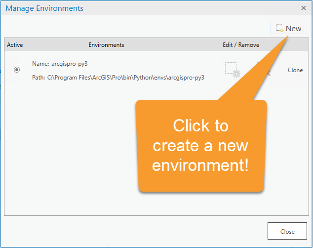

With the 2.2 release, we have modified the experience with the goal to keep arcgispro-py3 in a pristine state. The most immediate and obvious change is that in the python backstage (accessed by clicking Project then Python) if the arcgispro-py3 environment is active, the buttons to install or update packages are now disabled. To enable them you must first create and activate a New environment.

Q: I clicked the "New" button, but it's been running for minutes... is it going to finish?
A: The very first time you use "Clone" or "New" environment, conda pulls down the necessary packages and builds them.  This process can take some time, particularly if you have a slow connection or a slow machine. Subsequent operations will be significantly faster after the first, but the first must be allowed to complete. In the python backstage, the environment creation will be complete once the spinning progress bar at the bottom of the "Manage Environments" window disappears.
Q: What is the difference between "New" and "Clone"?
A: "New" always creates a copy of the default arcgispro-py3 environment, while "Clone" lets you clone a selected environment.
