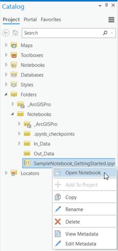

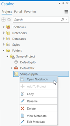

   1. To get started with notebooks in Pro, open a new project and from the Insert ribbon click New Notebook.
   2. After saving the notebook, open it using the Catalog pane.

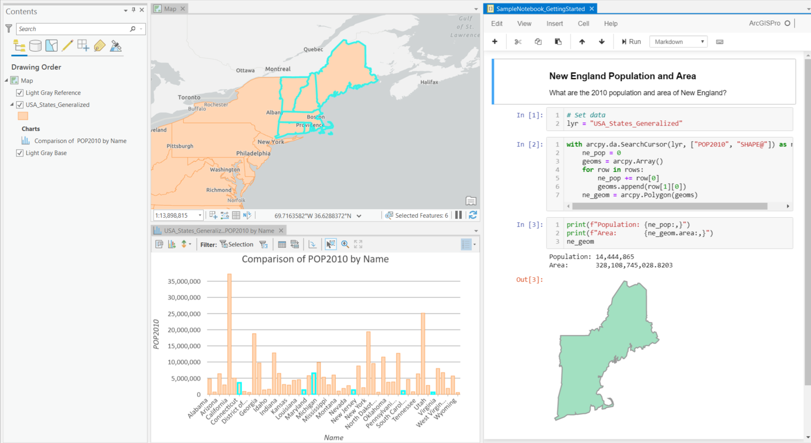

   3. You can arrange the notebook view so that you can see your map and notebook side-by-side.

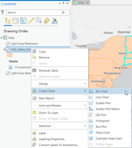

5. We are interested in the population of US states, so let's also open a chart. Context-click the USA_States_Generalized layer in contents and choose Create Chart > Bar Chart.
6. On the Chart Properties pane, under Category or Date, choose the Name field from the dropdown. Under Numeric field(s) check POP2010 on. Leave everything else on default and click Apply.
7. You can arrange the chart, map, and notebook views so they are all visible.

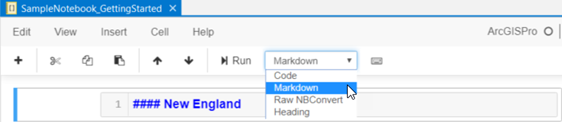

8. In the Notebook view, enter the following text into the first cell.
### New England Population and Area
What are the 2010 population and area of New England?‍‍‍‍‍‍‍‍‍
9. Select Markdown from the dropdown list above the cell, and then press shift+enter on the keyboard to run the current cell and simultaneously create a new cell below (or select the next cell).
The cell will be formatted in markdown and the entered text becomes a header and description for your notebook. This allows you to narrate the notebook and break it into sections.
10. From the Map ribbon click the Select button and select the states Maine, Massachusetts, New Hampshire, Rhode Island, and Vermont. These states are commonly referred to as New England. Note that the states are also selected in the chart.
11. Geoprocessing operations performed in the notebook will also honor selections made in Pro. Complete steps 12-14 with the New England states still selected.
12. Enter the following code into the next cell of your notebook and press shift+enter to run it.
# Set data
lyr = "USA_States_Generalized"‍‍‍‍‍‍‍‍
13. In the next cell, enter the following code and from the Cell menu of the notebook view select Run Cells And Select Below.
with arcpy.da.SearchCursor(lyr, ["POP2010", "SHAPE@"]) as rows:
    ne_pop = 0
    geoms = arcpy.Array()
    for row in rows:
        ne_pop += row[0]
        geoms.append(row[1][0])
    ne_geom = arcpy.Polygon(geoms)‍‍‍‍‍‍‍‍‍‍‍‍‍‍‍‍‍‍‍‍‍‍‍‍‍‍‍‍
14. In the next cell below, enter the following code and press control+enter, this will run the cell without creating a new cell below.
print(f"Population: {ne_pop:,}")
print(f"Area:       {ne_geom.area:,}")
ne_geom‍‍‍‍‍‍‍‍‍‍‍‍
With this tutorial, you have seen how you can use ArcGIS Notebooks interactively in ArcGIS Pro by bringing 2010 State Census data into your map, exploring population attributes with a chart, and then referring to the data by layer name in your notebook and operating on a selected subset of the data to obtain a summary of the total population and area of New England states. You can also use the arcgis library to analyze data using a pandas-based spatially enabled data frame.

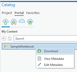

  • Using Notebooks hosted on Enterprise Portal in ArcGIS Pro: There are several options for moving a hosted notebook to your local machine.
    • Make sure you are signed in to a portal. From the Catalog pane in ArcGIS Pro, go to Portal > My Content, context-click a notebook item (if present), and select Download.

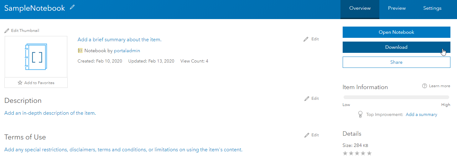

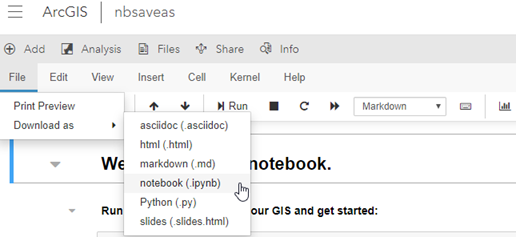

  • Signed into Portal on the web browser. From the Notebook Editor in Portal, on notebook menu ribbon, click File, then Download as and choose notebook (.ipynb).
  • Signed into Portal on the web browser. From the notebook's Item Details page (accessible from the Content tab by clicking on a notebook item), click Download to download the notebook in .ipynb format.

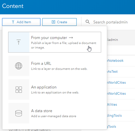

  • Using Notebooks created in Pro on my Enterprise Portal:
    • You can upload any notebook file (.ipynb) to your portal. To do this, sign into your organization's Portal from the browser, go to the Content tab of the contents page, click Add Item > From your computer and choose From my computer. From the Add an item from my computer dialog, click Choose File and browse to a notebook file on your computer, provide a title and tags, and then click Add Item.
