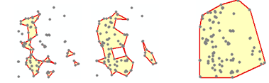

So, regardless of the implementation, they can be illustrative in exploring point patterns and generating containers to describe them.  I recently posted on the Minimum Area Bounding Ellipse (MABE) and I have a toolset that produces Minimum Area Bounding Circles (MABC), rectangles (MABR) and extent rectangles.  This implementation of the concave hull was proposed by Adriano Moreira and Maribel Yasmina Santos in about 2007 and there are several implementations in various languages on GitHub for those needing a trolling session.
The 'tightness' of the concave hull by changing the number of nearest neighbors to include when you are trying to decide on which points on the perimeter to keep or dump.   This 'K' factor illustrates some of the possible outcomes.  The thing to watch out for is producing degenerate points which are outside the hull, but are just to much of an outsider to be allowed into the fold.  So in pictoral form,
3 neighbours
7 neighbors
11 neighbors
And finally... with the convex hull surrounding it.

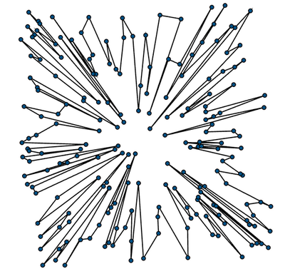

And if that isn't tight enough for you, radial sorting and concave hull generation is as tight as it is going to get
