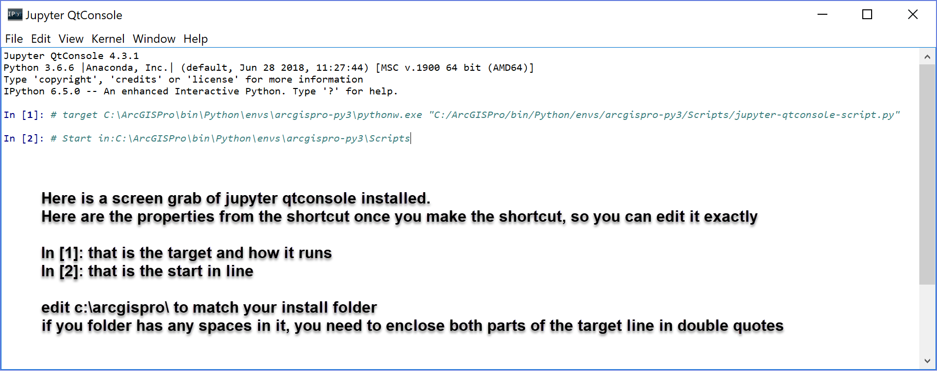

I like to have stuff easily accessed. Desktop icons work for me. Here is an example of having the pro.bat, Spyder and Jupyter IDE icons created and organized in one spot.
Launch File Explorer and find your installation folder. In my case, I installed Pro in a folder with the same name.  The rest of your folder structure will be the same after this point. Navigate to the jupyter-qtconsole-script.py script within the path (see 1 and 2 in the figure)
Once the properties dialog is open, click on Shortcut, then ensure your path emulates the example below.  It consists of two parts... the first is the location of python.exe within the installation path... the second is the aforementioned script which is run and noted above.  I make sure that the Start in: is specified as well.
If you work on your machine solely, you can click on the Advanced button in the previous dialog and toggle off the Run as administrator checkbox.  This will just avoid you having to answer a security question when the shortcut is used.
And now you are done.
I created one for proenv.bat as well as Spyder for ArcGIS Pro since I use different versions of Spyder and python and separate conda distributions, so I keep different shortcuts.
Here are the equivalent options for the Spyder shortcut.
Target...  (pythonw.exe location and the spyder-script.py location)
         C:\ArcPro\bin\Python\envs\arcgispro-py3\pythonw.exe "C:/ArcPro/bin/Python/envs/arcgispro-py3/Scripts/spyder-script.py"

Ren... did you install it jupyter qtconsole that is??
A picture once you install it

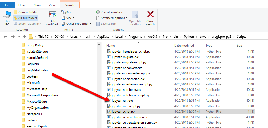

No, I didn’t install it because I couldn’t find the file ‘jupyter-qtconsole-script.py’ it’s not in that directory. Where does it get generated from? Should I run ‘juputer.exe’
Here is a screenshot from my file explorer showing the ‘jupyter’ files that are in that directory:
C:\Users\rrosin\AppData\Local\Programs\ArcGIS\Pro\bin\Python\envs\arcgispro-py3\Scripts
Ren Rosin

DanPatterson_Retired
MVP Emeritus
Ren
There are several 'jupyters' each are different, you will have to decide which one you want
jupyter qtconsole
jupyter notebook
jupyter labs
or all of them for a full constellation
It is kindof like Arc.... software …. similar names, different functionality etc
Besides if you are on the clone side of the clone wars, just use Pro's package manager... it will install them for you then you can find the scripts and make the shortcuts.
I did conda installs of all the jupyters and they work fine, but I don't use the clone approach
