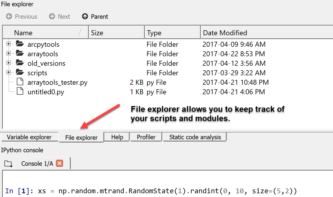

Here is the file explorer as an example

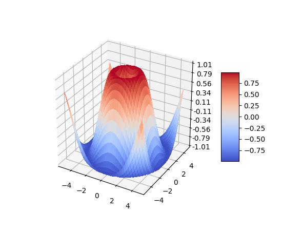

Need a quick Matplotlib graph/?? no problem
