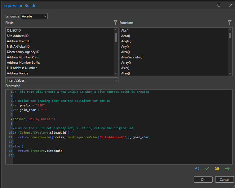

When editing Attribute Rules, you normally just open the Attribute Rule pane and type your script into the editor, this is not good if you want to maintain an edit history of your code:
If I make a change here, and someone else goes to use this project later, there's no easy way for them to see what I've changed or even that I changed anything.

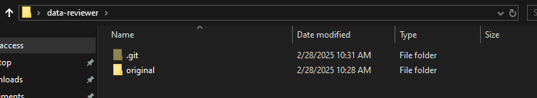

Using the arcade-manager Tools, we can extract the current state of the Attribute Rules in this database to plaintext:
I can now open that repository in my code editor of choice and initialize a git repository:

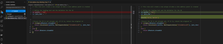

After making the initial commit, let's go back to that Site Address ID rule from the first screenshot and make a change:
Now we can re-run the Extractor tool, and open our IDE again:
As you can see, the changes are now detected by git! We can now add a commit message and keep track of the changes we've made.

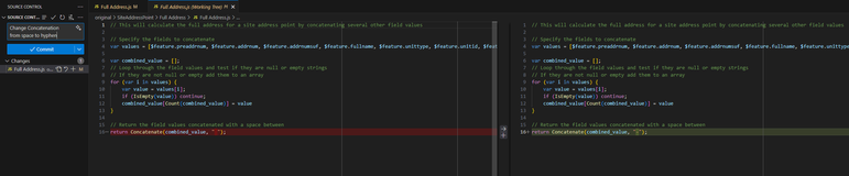

It's pretty nice to be able to track Attribute Rule changes that are made in ArcPro, but what about applying changes made in your IDE?
Let's change how Full Address is concatenated:

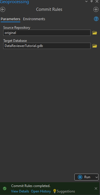

Commit these changes to your repo, then open your ArcPro project again and go to the `Commit Rules` Tool:
As you can see, the changes were applied!

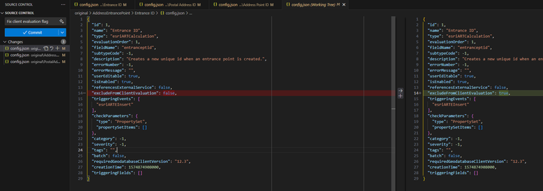

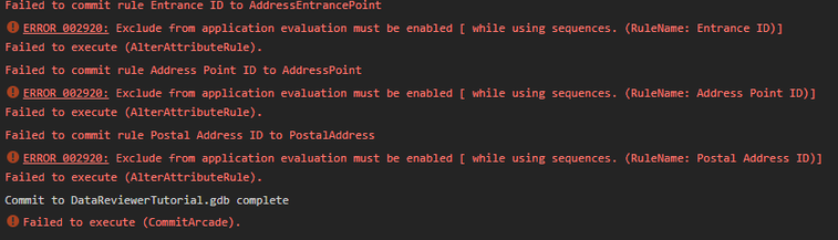

ArcPro allows you to have invalid rules sometimes. This can happen if a table is moved and a $datastore is lost, or if a flag got accidentally set, etc. The arcade-manager tools will report any and all errors with your rule scripts:
As you can see, this example database has the application evaluation flag set incorrectly for several rules, let's got fix that:
Now we can re-commit our repo to the database and there are no errors:
