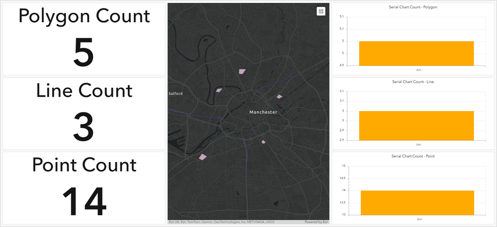

Hi @hoelhaddouni,
I have not been able to reproduce the issue. I tried with all data types (polygon, line, point) in a Postgres 15.5 Enterprise Geodatabase.
Might be worth doing an investigation if you had any recent patching done.
Regards,
Glen
