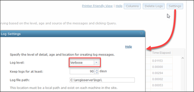

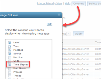

5. Here is what I did?
a) Set Log Level to Verbose from Settings.
b) Add Time Elapsed from Columns
c) Make an Export call
d) Set Log Filter to Verbose and click Query
the stranger thing is that the same layers are very fast within a different database and map service.!!
Yes, that is strange. Please start with Server log, that should give you clue about what is taking more time - drawing or data access. I'd suggest to get the same matrices from both map services to compare. If you see it is data access that is taking more time. Then you can do database trace.
