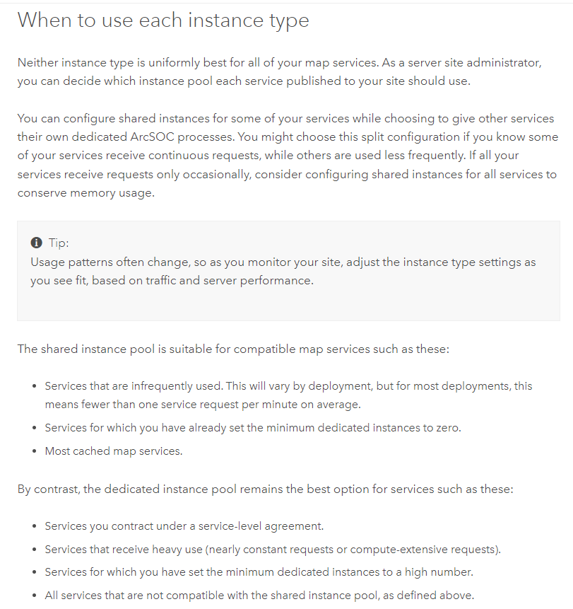

Adding these links to help with this discussion.
Tune and configure services—ArcGIS Server | Documentation for ArcGIS Enterprise
Configure service instance settings—ArcGIS Server | Documentation for ArcGIS Enterprise

Indeed, also keep an eye on the server cpu and memory utilization, the dedicated service might have started to fail because the machine was running out of memory, the server needs enough free memory to accommodate the min-max number of SOC processes for the dedicate service, if the system is under heavy load and other services are consuming more memory then dedicated services might not be able to spin more SOC processes based on the min-max number that is configured. Hence, once you switched the service from dedicated instances to shared instances the system start to respond again. This is definitely something that you can keep an eye on to see how server memory is been used. Esri ArcGIS Monitor is a tool that can be used to monitor the server cpu, memory, disk but also to monitor the ArcGIS Server Services and you can create email alerts if a particular Service crosses a threshold metric value that you define, excellent tool to monitor ArcGIS Enterprise deployments.
Introduction to ArcGIS Monitor—ArcGIS Monitor | Documentation

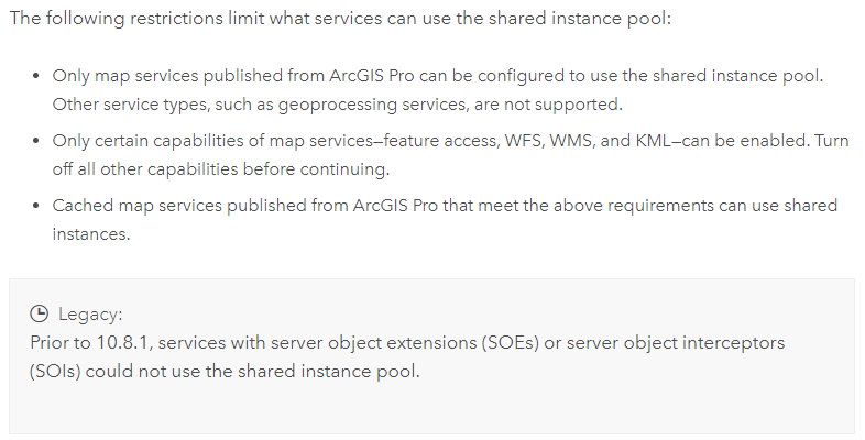

I believe the error message you're getting is due to a publishing incompatibility.
You should use ArcGIS Pro 2.9.x to publish to Enterprise 10.9.1, please see: https://pro.arcgis.com/en/pro-app/latest/help/analysis/geoprocessing/share-analysis/geoprocessing-se...
This may affect the performance of your geoprocessing tool as the checks for additional parameters are failing.
You are correct that the user should experience the same performance with dedicated vs shared instances. Important to note if you're dedicated minimum instances are set to "0", the instance start-up (on user request) does take some time depending on the complexity of the tool/map service.

A Wyn - that is interesting regarding 2.9 + 10.9.1 for GP services, I did not know that.  In our case however, the service in question is a pretty vanilla map service - no feature access, not a GP service, no custom settings or anything unusual about it.

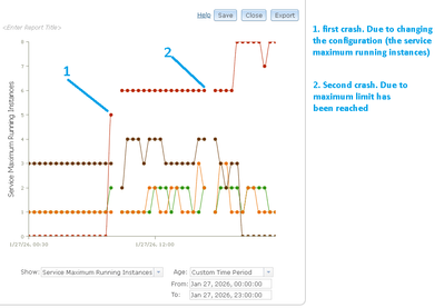

I want to share my experience. Hopefully its still related.
It seems that changing the service type from Dedicated to Shared does effect the system. In my experince, Shared Instance is way better...
Here is the graph of Service Maximum Running Instances of 4 Service :
1. Map Service 1 (min 2, max 4)  --heavily used
 2. Feature Service 2 (min 2, max 7)  --heavily used
3. Feature Service 3 (min 1, max 2)  --seldomly used
4. Map Service 4 (min 1, max 4)  --seldomly used
Here is the graph of Max running Instances :
The previous value of Map Service #2 was Shared while the others are the same. The system runs smoothly. No error.
Can anyone explain what are the drawbacks of Shared compared to Dedicated in terms of data being collected ?
I read that if using Shared, the instance can be destroyed if maximum time has passed. What does it really means ? losing data that has not been saved during edits ? or something else... ?
