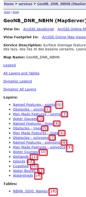

I have a table included in each of my services that is linked to a relationship class to bring up assessor information.  The URL is pretty straight forward...but it ends in a number after MapServer/109.  Do you happen to know where I would I find the URL for this table?

You should be able to find it in your REST Services Directory.  Here is an example from our REST Services:
https://geonb.snb.ca/arcgis/rest/services/GeoNB_DNR_NBHN/MapServer
Bernie.

Perfect.  Thank you, Bernie!  You always teach me something.
This is not necessarily the answer to the question I posed, but using ArcGIS Online Assistant should get me there without having to re-add web layers which is a plus in my book.
